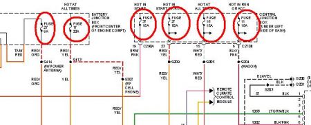

every light up but the radio dont come on or the time.

Start by making sure all these fuses are good,
https://images.2carpros.com/forum/automotive_pictures/55316_02sableradio_1.jpg
