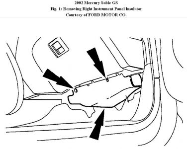

The blower for my air conditioner will sometimes work and then I could get in my car and it not work. This just started happening. What could the problem be and how can my husband fix it? Where is the blower motor? How do you get behind the panel to the switch for the a/c?

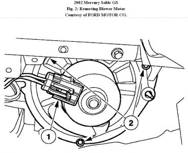

Hi bonitagator, Thank you for the donation. Symptoms indicates the blower motor is failing and has to be replaced. Blower is located behind the glove box. When blower fails to work, give the housiong under the glove box some banging and if the blower starts, it indicates the carbons are running out and motor would fail completey soon. BLOWER MOTOR Removal and Installation 1. Remove pin-type retainers and the right instrument panel insulator.
https://images.2carpros.com/forum/automotive_pictures/192750_BlowerMotor02SableFig01_1.jpg
2. Remove the blower motor (19805). 1. Disconnect the electrical connector 2. Remove the screws and remove the blower motor.
https://images.2carpros.com/forum/automotive_pictures/192750_BlowerMotor02SableFig02_1.jpg
3. To install, reverse the removal procedure.
