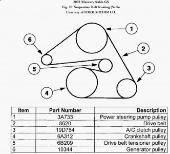

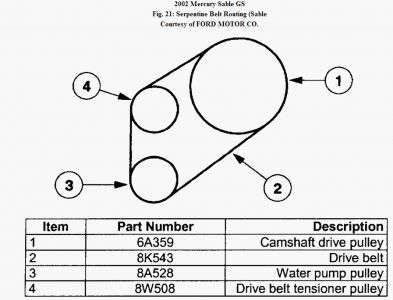

I need a diagram of the motor, the outside, trying to get belts on plus the small belt for the cam shaft and water pump.

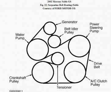

The first two pictures are for 3.0 with 8th letter of VIN is "S" the last is VIN "U" I think you have the S...
https://images.2carpros.com/forum/automotive_pictures/62217_30Sa_1.jpg
https://images.2carpros.com/forum/automotive_pictures/62217_30Sb_1.jpg
https://images.2carpros.com/forum/automotive_pictures/62217_30U_1.jpg
