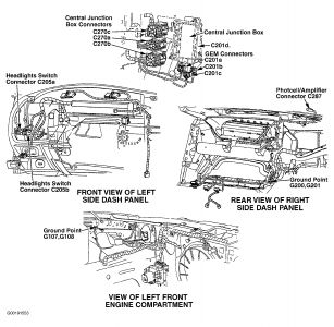

Hi, I have had this problem for a while. When dircing at night, everyonce in a while my headlights will go out on me. The first time, I went over a bump in the road. Eventually, the automatic headlight system went completly out, and i must use the maunal switch. I did not think much of it and asked the service department if there was by chance a recall and they said sorry, but no. Then the other day, i was traveling with one of my co-workers, who also has a 2002 Mecury Sable, and i ound out he is experiencing the exact same problem, except his has not gone out completly.

Sounds like the GEM Module has gone bad it is located under left side of instrument panel attached to under side of central junction box however you will need a special tool to upload the module information to down load into a new one but you can buy one from a salvage yard that will already be loaded. I have included a diagram so you can see where it is. Hope this helps
