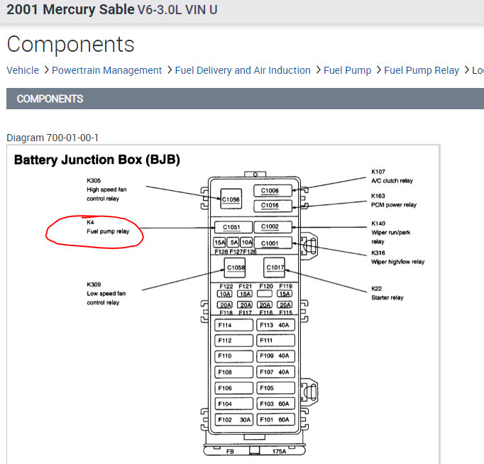

where is the fuel pump relay?
2001 MERCURY SABLE
01SABLE
has no fuel pressure, has power at the fuel pump fuse, where is the fuel pump relay
Aug 6, 2010 at 1:21 AM
SQM
  • 6,383 POSTS
The fuel pump relay is located in the junction box under the hood (see diagram below).
Be sure to check for any corrosion on the terminal and any burnt pin (s).
You can also check to see if you are getting power to the relay.

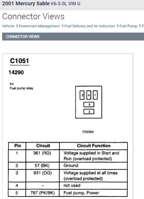

Here is how to test the relay:
