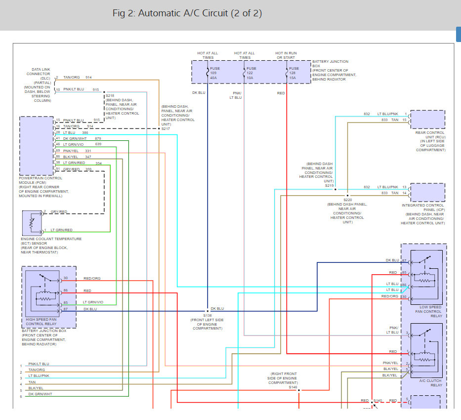

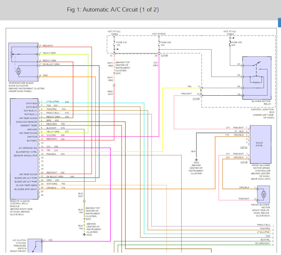

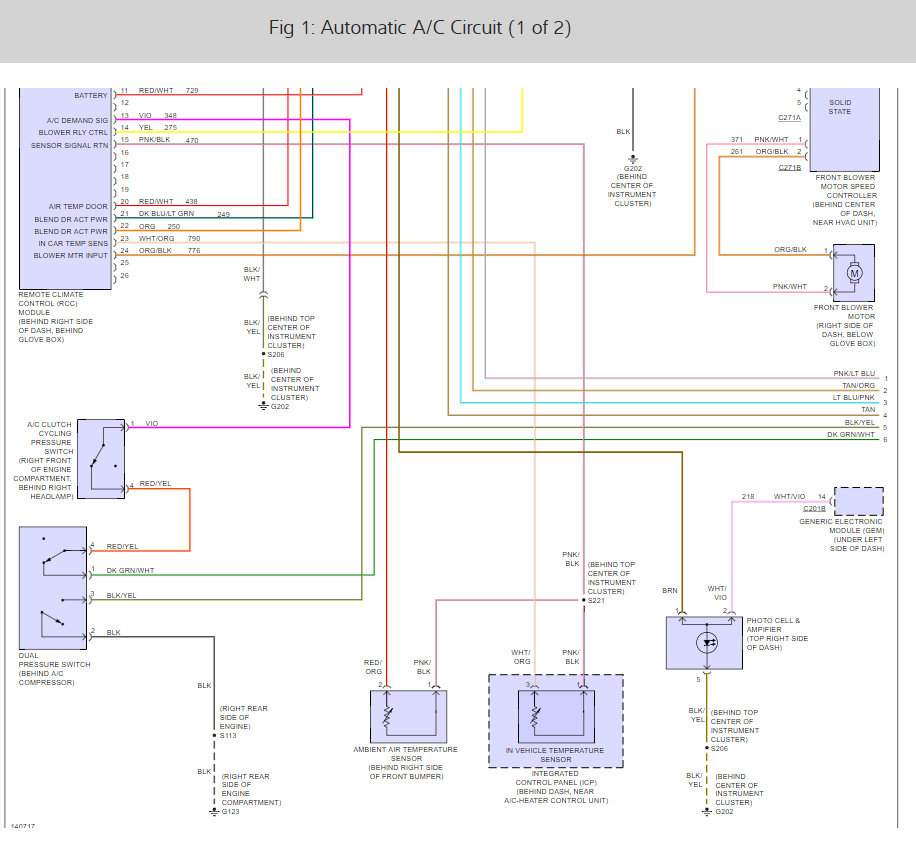

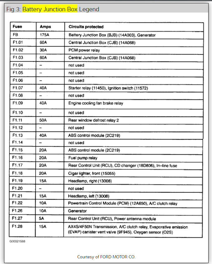

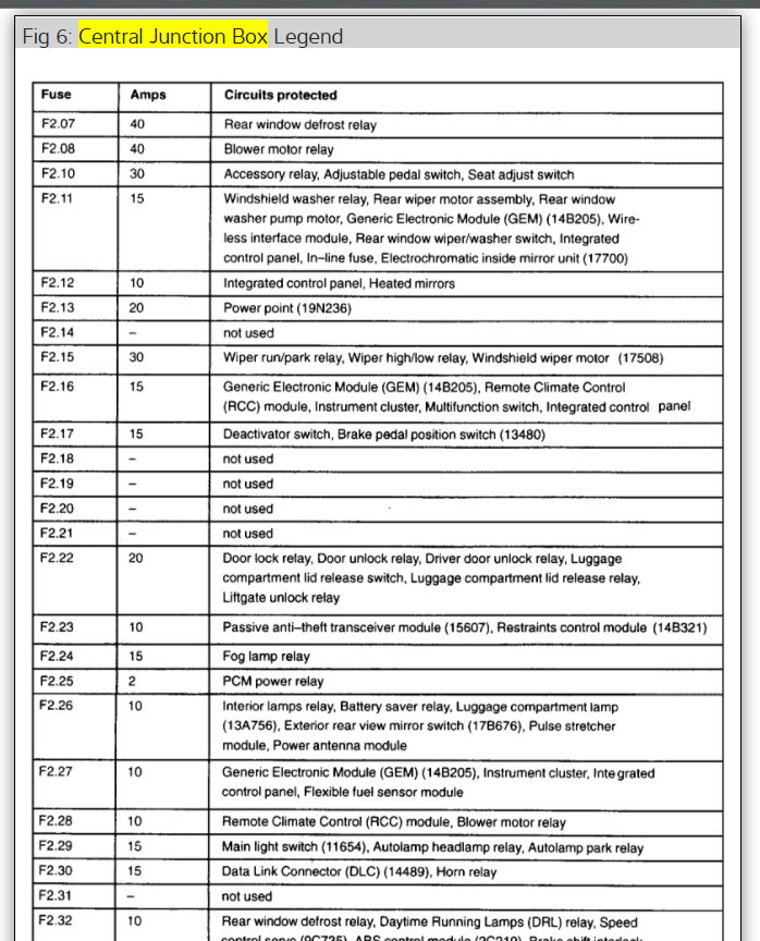

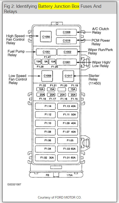

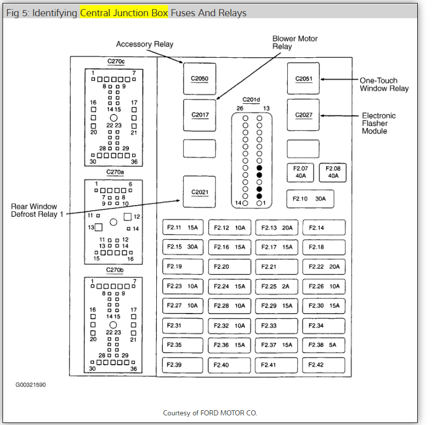

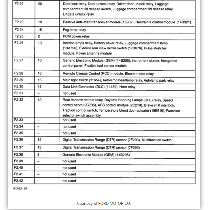

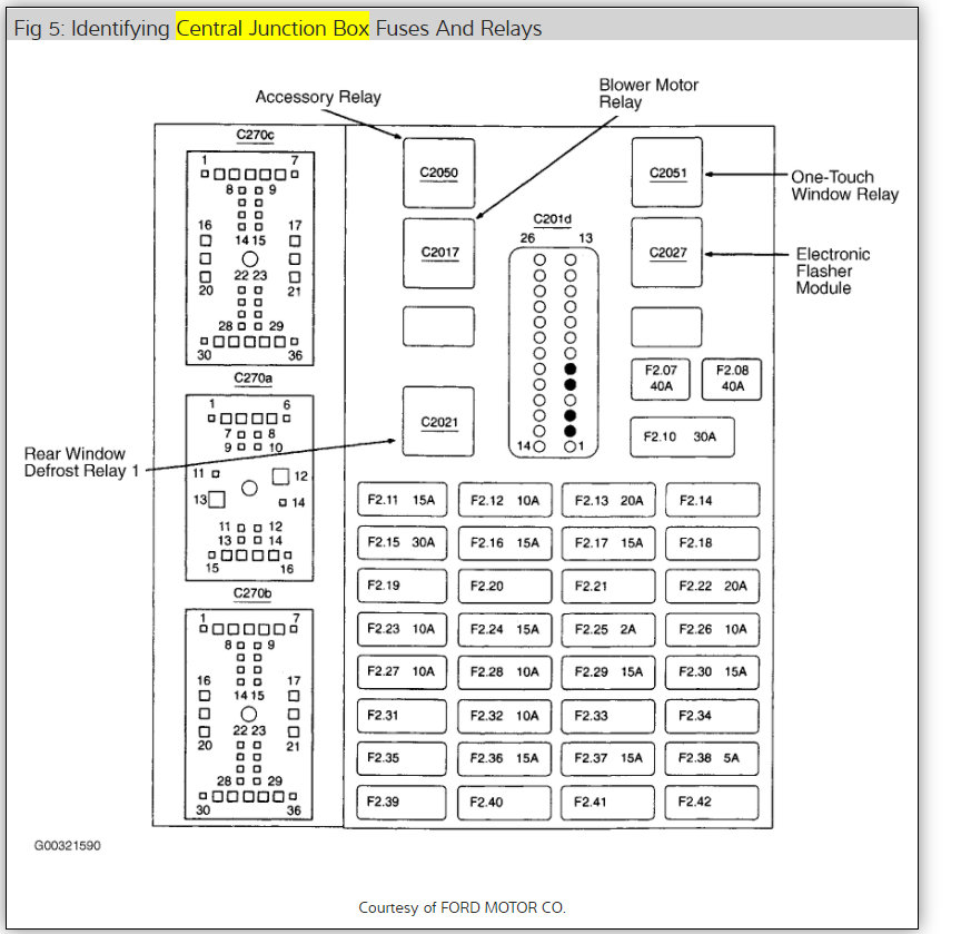

Here are the wiring diagrams for the air conditioner so you can see how the system works.

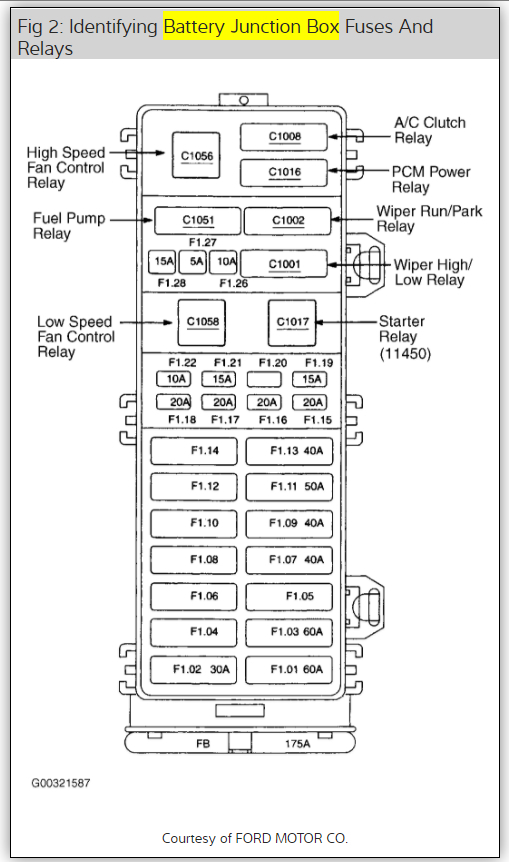

There are 6 fuses that run the system lets start by checking them by using the wiring diagram to show you the fuse numbers below.
