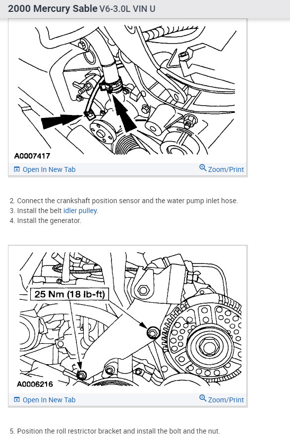

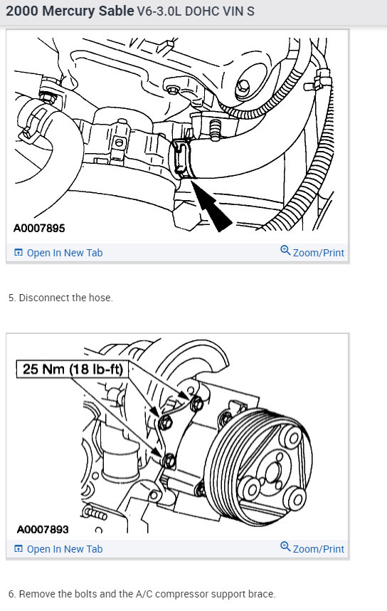

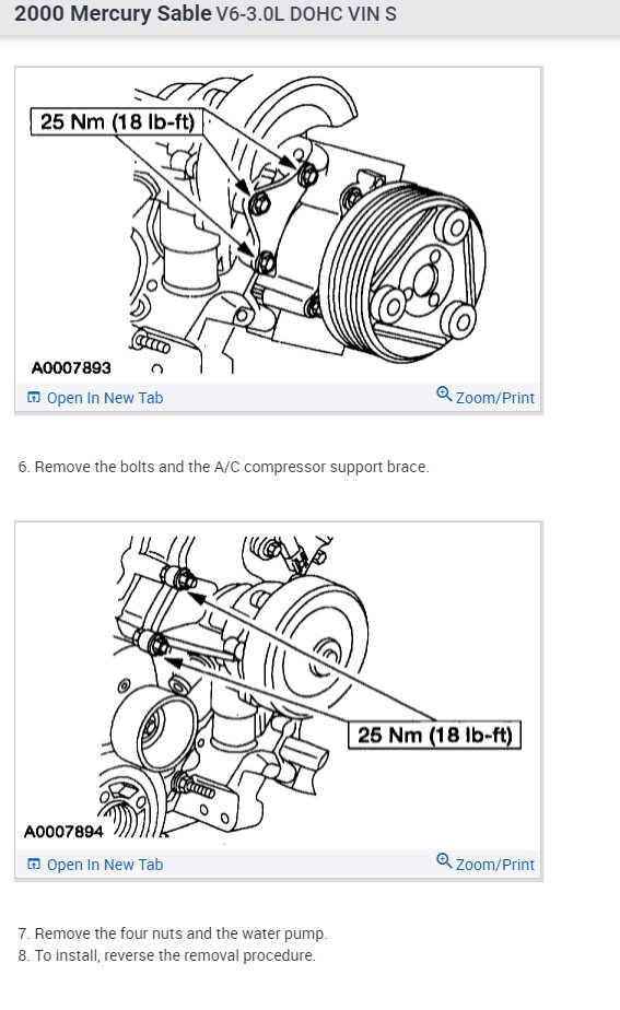

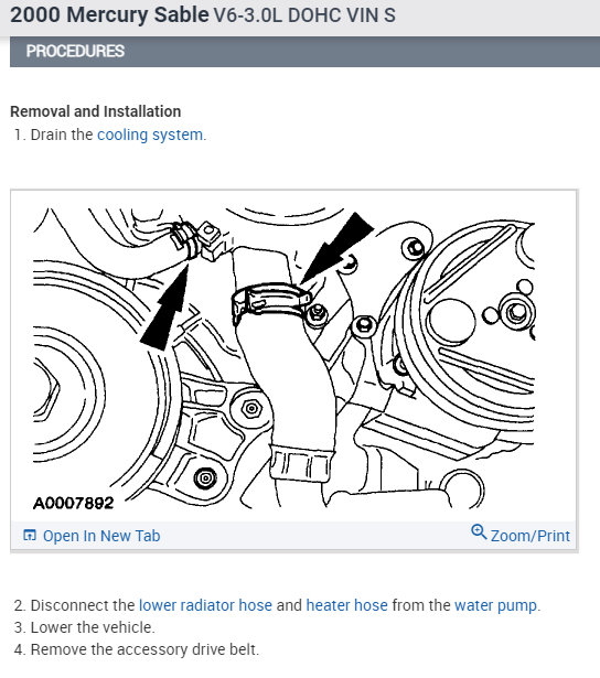

I saw your other post stating DOHC.
See if this helps
Removal and Installation
Drain the cooling system.
https://www.2carpros.com/forum/automotive_pictures/309872_84796135_1.gif

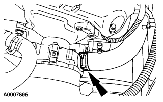

Disconnect the lower radiator hose and heater hose from the water pump.
Lower the vehicle.
Remove the accessory drive belt.
https://www.2carpros.com/forum/automotive_pictures/309872_84796136_1.gif

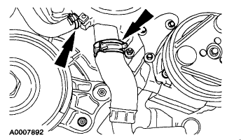

Disconnect the hose.
https://www.2carpros.com/forum/automotive_pictures/309872_84796137_1.gif
Remove the bolts and the A/C compressor support brace.
https://www.2carpros.com/forum/automotive_pictures/309872_84796138_1.gif
Remove the four nuts and the water pump.
To install, reverse the removal procedure.

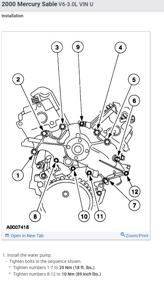

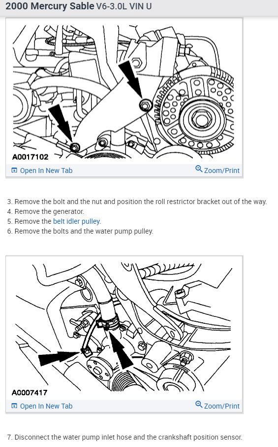

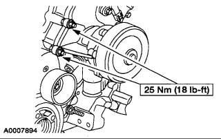

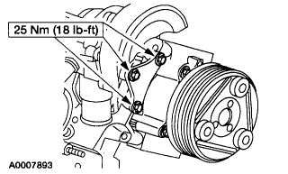

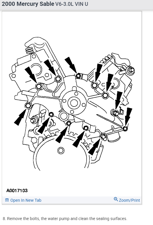

SQM
  • 6,383 POSTS

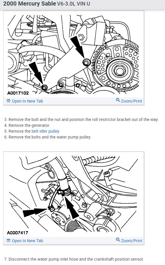

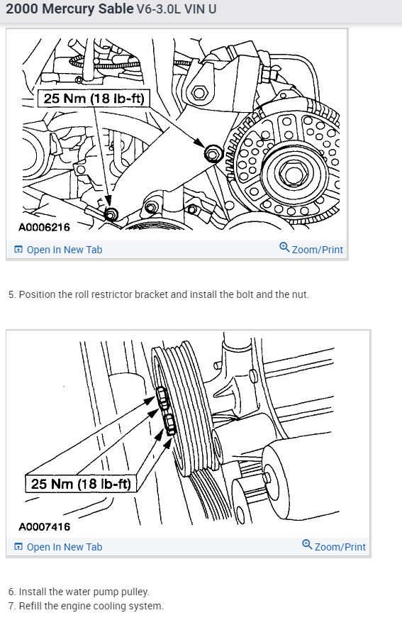

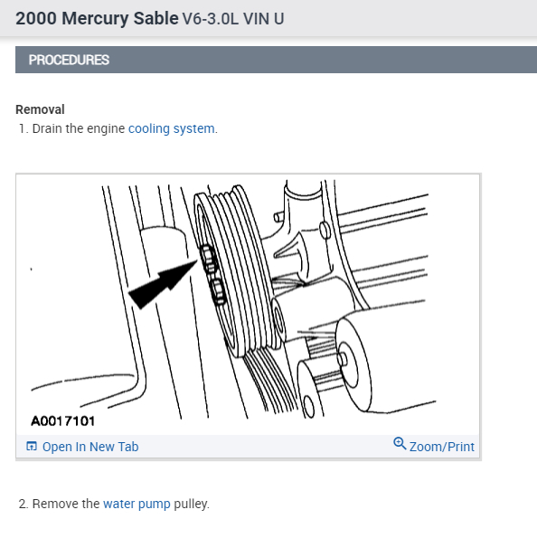

For anyone who might be looking for water pump replacement instructions, I have attached both of the 3.0 OHV and 3.0 DOHC engine's water pump replacement procedures.
https://www.2carpros.com/articles/water-pump
https://www.2carpros.com/articles/water-pump-replacement
