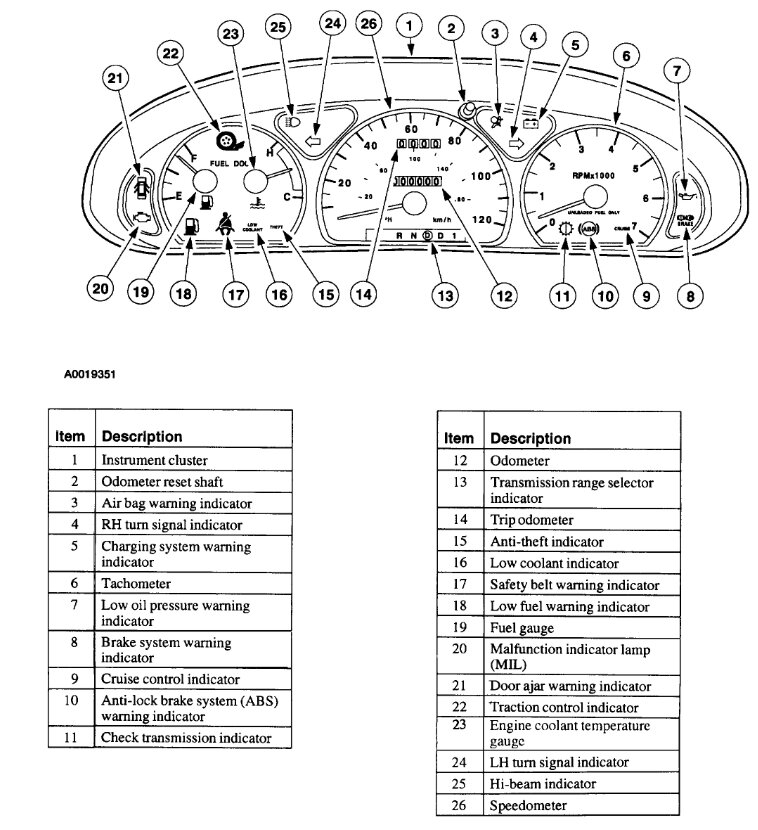

I put them back on yesterday, and everything is fine as far as the stoping, pedal, etc, but the orange warning light with the gear, and ! comes on after about 5 miles. When the engine gets turned on, it does not come on immediately.

I'm not sure what you are seeing there. The only thing close to looking like a gear is actually a tire and it's the low tire pressure warning. See if you can identify which one from this. Check out the images (below). Let us know how it goes

It is a yellow/orange circle, with teeth on the outside of the circle, and a ! (explamation) point in it.
it is just to the left of the ABS light.
The diagram is really poor quality, but it probably is #11

That has nothing to do with brakes. That is a "Check transmission" light. It indicates that the Transmission Control Module has monitored a malfunction and stored a trouble code to identify it. You will need a professional scan tool to be able to read the code which will get you pointed in the right direction. I recommend a transmission shop.
