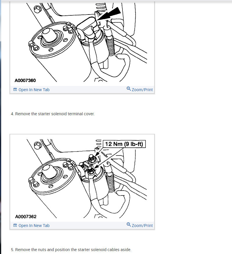

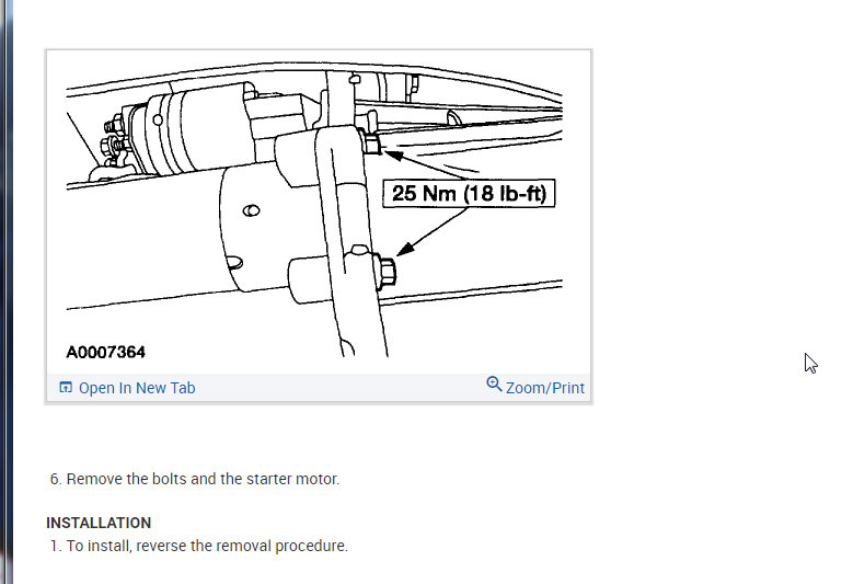

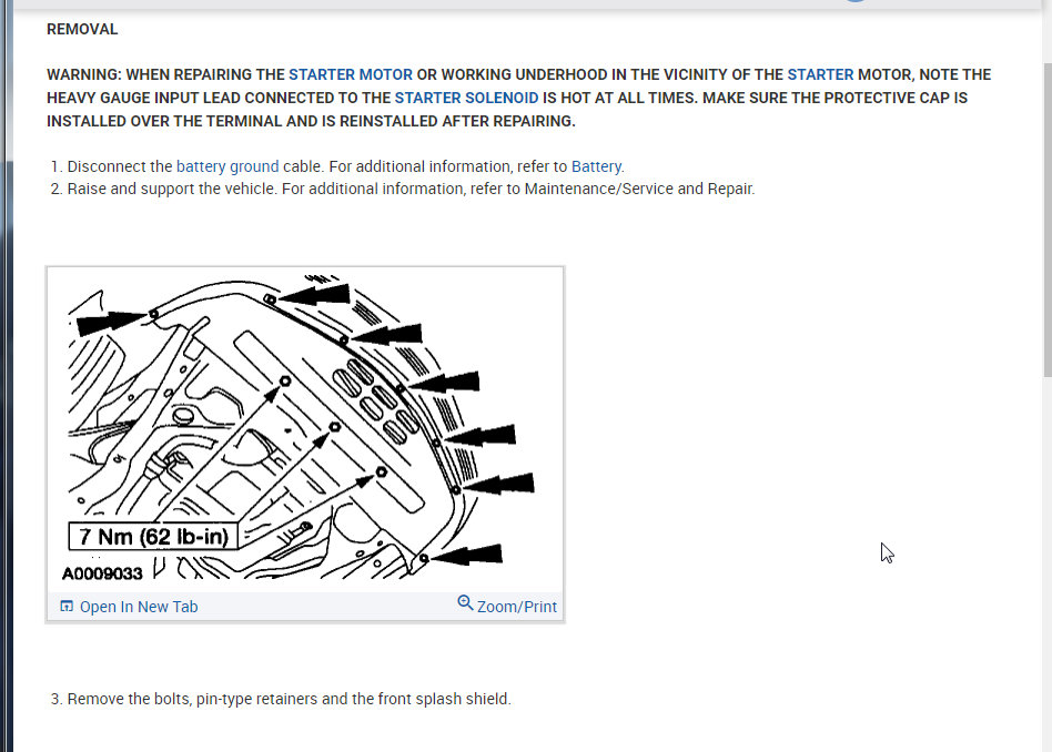

Where is the starter located?
Saturday, August 8th, 2009 AT 6:12 PM
MECHANIC
18,907 POSTS
I am attaching the process from the manual for your review. Also, here is a guide that will help as most of these are pretty similar so this should help as well:
Let us know what other info you need and we can go from there. Thanks
