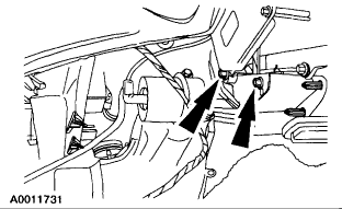

Blend Door Motor
REMOVAL
https://www.2carpros.com/forum/automotive_pictures/12900_b1_10.gif
Remove the integrated control panel. Refer to Climate Control Assembly-Integrated Control Panel.

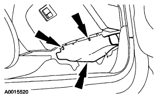

Remove the right-side lower instrument panel insulator.
https://www.2carpros.com/forum/automotive_pictures/12900_b2_6.gif
Remove the temperature blend door linkage shield.
https://www.2carpros.com/forum/automotive_pictures/12900_b3_6.gif

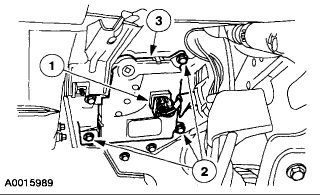

Remove the temperature blend door actuator.
Disconnect the electrical connector.
Remove the screws.
