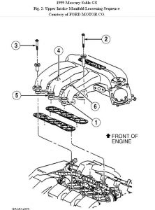

I need torque seguence for upper intake manifold. Need to remove this to put spark plugs in rear of motor. The motor has duel overhead cams.
6 cyl Front Wheel Drive Automatic

Hi tburnside, Thank you for the donation. The diagram is removal sequence. For installation, reverse the sequence. Tightening torque is 71 - 106 inch/lbs ( 8-12 N.m ).
https://images.2carpros.com/forum/automotive_pictures/192750_Intake99MercuryFig02_1.jpg
