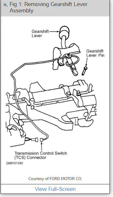

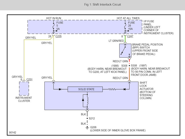

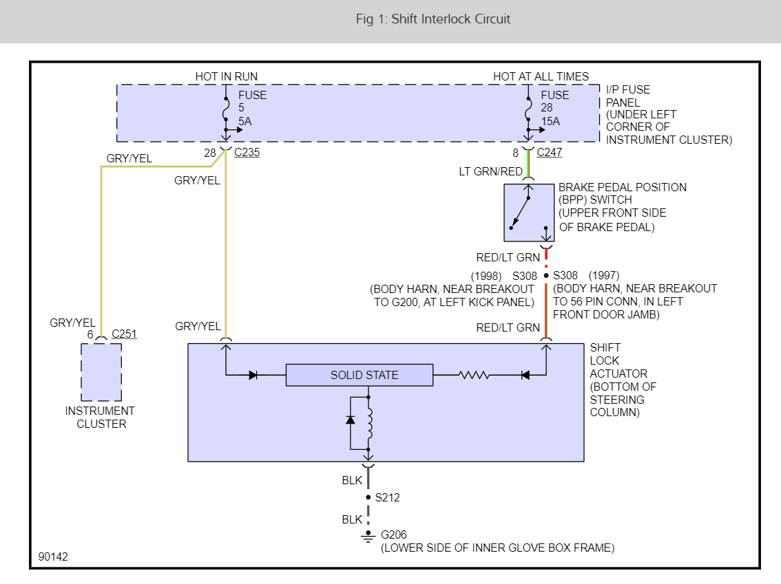

There is a shift interlock system that does not allow you to take the transmission out of park it must be getting worn and the cold weather is affecting it. I would replace the shift lock actuator or at least try to lube it.
(Here are some diagrams Below)
Cheers
Jul 12, 2009 at 12:45 AM
CLARENCE POHL
The actuator for depressing the brake pedal is in the steering column you will need to remove the cover first. I replaced the actuator and the problem is fixed, Thanks 2Carpros
