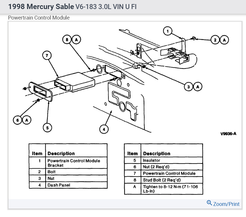

Could you tell me where the PCM relay is located.
May 7, 2009 at 12:25 PM
BMRFIXIT
  • 19,053 POSTS

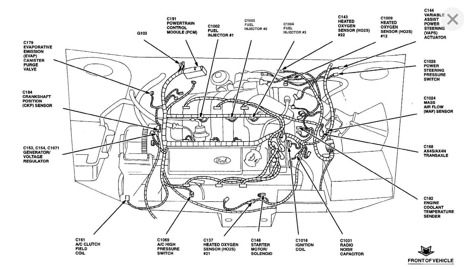

Yes it is sitting on top of the heater plenum inside the car but the connector is under the hood here are 2 diagrams to show you the location and how to remove it.
Cheers
May 9, 2009 at 6:33 PM

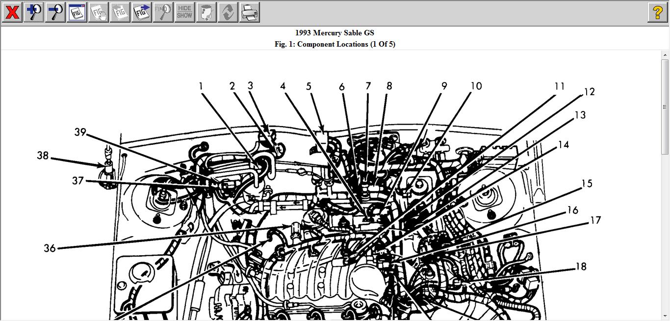

Were is the engine control computer located on a 1993 Mercury Sable?
Aug 11, 2018 at 3:07 PM (Merged)
  • 75,992 POSTS
See item no.37
