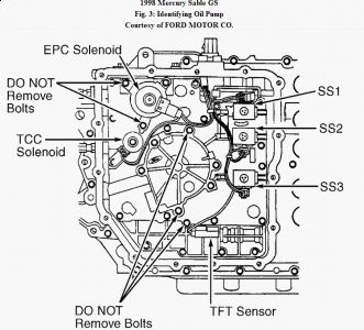

I have a 98 mercury sable that needs sensors, i've replaced tran a wanted to take a crack at internal repare
does any one know were the 3 sensor for 1st, 2nd ,3rd gear shirft are and any specialty tool's needed

Might help us to know what the symtoms of your problem are? But heres the Shift solinoids, remove the pan and they are exposed.
https://images.2carpros.com/forum/automotive_pictures/62217_SS_1.jpg
