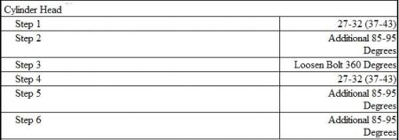

1998 Mercury Sable
tourque procedes for the head bolts
Jun 27, 2010 at 11:28 AM
BLUELIGHTNIN6
  • 16,542 POSTS
https://images.2carpros.com/forum/automotive_pictures/261618_Noname_2383.jpg
