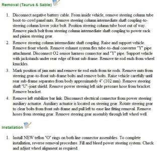

how do you change the rack and pinion

https://images.2carpros.com/forum/automotive_pictures/261618_Noname_2195.jpg
