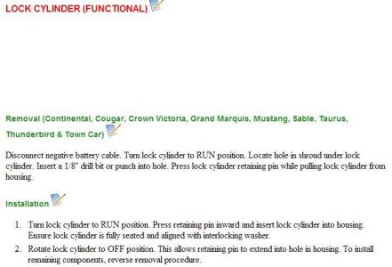

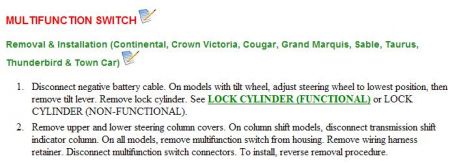

My husband is trying to figure out exactly how to replace the multifunction switch in our steering column, he knows that he has to pull the steering wheel. What else is involved, such as how to do take the spring that turns the wheel off and on, specs on replacing the switch etc.? Any suggestions as to where we can find this information. We looked through teh Chilton and Haynes repair manuals and they were not very helpful.

Steering wheel DOES NOT need to be removed...Replacement procedures for your vehicle's multi-function switch are below...

I just wanted to thank you sincerly for this information, it took my husband 20 minutes to do the job and everything is now working perfectly!
