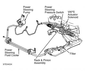

I've working in electronics and computers for the last 30 years troubleshooting all kind of problems. If two symptoms occur at exactly the same time and with the same apparent input they are related. The power steering goes out the same instant that the windows quit working and both go out when the moving from drive to reverse. I don't have the resources to look up exactly how this model of auto does its thing as I don't have the factory manual on it. However, on the Steering column just under the dash is a wheel with equally spaced holes around it that pass by some type of sensor. My computer/electronic experience tells me this is a sensor that is telling the cars computer/controller when the steering wheel is turned and which direction it is turning. My logic leads me to believe that the computer then tells some actuator somewhere to engage the power steering hydraulics to assist with the turn. I believe that this whole problem is electrical and possibly has to do with a bad connection somewhere in the steering column and/or the body control module and possibly its ground as mentioned above. The location of the body control module would be helpful. Also a few pointers on removing the covers on the steering column would help.
Jun 11, 2010 at 9:04 AM
  • 110,194 POSTS
I believe the item that you are refering to is for speed sensative steering. Ford Motor company capps it variable assist power steering (VAPS). As you slow down, it increases the power assist. As you speed up, it does the opposite. After researching for a while, I may have determined your problem. There is a "GEM" which stands for generic electronic module. It is located behind the fuse junction panel in the vehicle. You need to first check to see if the GEM will communicate with a scanner. If there is no communication, it's bad. If there is, it should give you diagnostic codes to identify where the problem is coming from. Also, check the GEM for any evidence that water has gotten to it from a leaking windshield. From what I have found, that could be a problem. Here is a picture / schematic of the PS system. Also, I tried to upload a schematic of the wiring, but it was too small to read.
