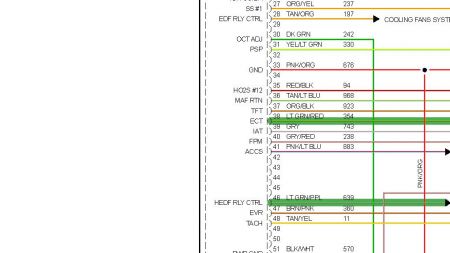

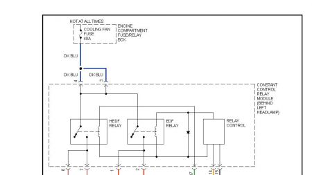

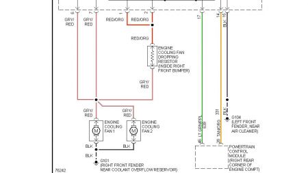

Sounds more like the CCRM. The PCM has to see the input signal from the ECT to get the fan going- Might want to have the CCRM pulled for codes-Not only that the CCRM powers the cooling fan it also powers the fuel pump and AC magnetic clutch-

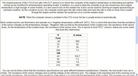

Test the PCM pin outs see below-Did you test the ECT?
https://images.2carpros.com/forum/automotive_pictures/12900_ect_3.jpg
https://images.2carpros.com/forum/automotive_pictures/12900_hedfect_1.jpg
https://images.2carpros.com/forum/automotive_pictures/12900_ect_testing_1.gif
Expect a reading from 0.8-1.2 volts for most cars.
