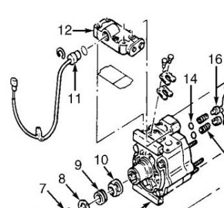

Hi- I needed an ac compressor for my 1995 Mercury Sable 3.8L engine, and bought it used, but the mechanic says we need the part that screws onto the four posts shown in this picture. He says it will come with two hoses. Can someon tell me what the part is called? (I'm in Mexico and don't speak Spanish well) Thanks.[img:076ecb1ffd]http://www.2carpros.com/forum/automotive_pictures/260082_IMG_0137_1.jpg[/img:076ecb1ffd]

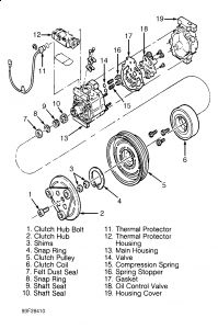

HI there, Thank you for the donation. i think the part you are referring to is the thermal protection housing, see pic item 12. mark (mhpautos)
https://images.2carpros.com/forum/automotive_pictures/61395_1_5.jpg
close up view,
https://images.2carpros.com/forum/automotive_pictures/61395_Noname_69.jpg
