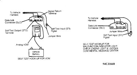

I have a 94 mercury Sable..bout a week ago it started acting up..After you drive it for about 30 minutes it seems like it dies out you could have the gas pedal totally pressed and nothing the speed just starts dropping..Then after a minute or 2 it will buck and drive normal for a few minutes than right back to the same thing again..its almost as if the car is off for that minute or 2 no noise or anything

Check engine light on or flash? suspect fuel pump issue need to have pressure checked should be 40-44 psi.

comes on when its having the issue but then it goes off when the car jumps back into normal

Try and see if code is set indiagram the figure on right
https://images.2carpros.com/forum/automotive_pictures/198357_Graphic_423.jpg
Jump from large connector to single wire connector. Then key on NO START check engine light will flash so flash,pause,flash, flash, pause, flash= 121 post codes maybe will tell what is going on.

I noticed something new today when i came back from a run by the time i hit my street it was barely making it it started sputtering like it wanted to cut off then in my driveway it kick in the engine reved and it took off..but i noticed a very strong smell filling my car it smelled like gas..i put fuel injector cleaner and also a bottle of iso heet..HELP..

That could not hurt the diagnostic plug is under hood
