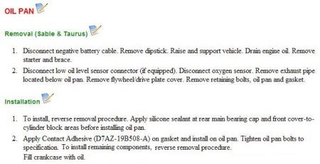

How do I get the oil pan off of a 3.8 litre sideways mounted engine. I think I need to remove a transmission cover plate but I do not know how to get access to any bolts holding this plate on. Also do I need to remove the starter?

https://images.2carpros.com/forum/automotive_pictures/261618_Noname_1125.jpg
