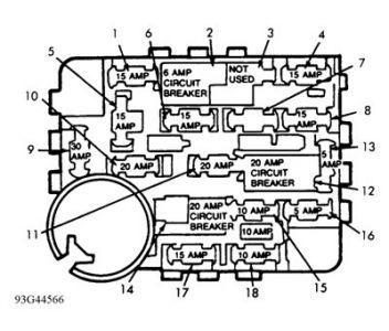

where is fuse for radio

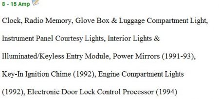

The radio fuse is #8
