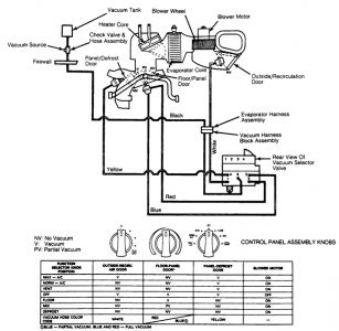

after it comes from the intake manifold, the line goes into this distribution block on the passenger side then there is a line that goes down towards the wheel well, but it chewed off. do you know what that is supposed to be going to? and the other line goes into the firewall right by the heater core, but isn't there another distrubution block somewhere after the firewall?
Jun 9, 2010 at 2:12 AM
BLUELIGHTNIN6
  • 16,542 POSTS
here is the entire vacuum diagram for your HVAC system
https://images.2carpros.com/forum/automotive_pictures/261618_Graphic_563.jpg

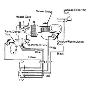

The only other thing I could use help on is how to get to the reservoir, and what size vacuum line would I need to replace it all with? thanks you have been really helpful so far!
Jun 9, 2010 at 9:16 AM
BLUELIGHTNIN6
  • 16,542 POSTS
the vacuum resevoir should be under the hood, near the firewall, i'm not certain of its exact location though. just cut a piece off of the vacuum hose that has already broken and use that same size
https://images.2carpros.com/forum/automotive_pictures/261618_Noname_2324.jpg
