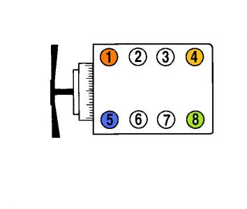

My code scanner says misfire on #4.I intend 1st to install new spark plugs.1-Which is #4?. 2. What is prcedure for installing new,i.e is it necessary to remove fuel pipes feeding injectors?

What kind Of Mercury? What engine? No it isnt necessary to remove the fuel rail,pull the coils out and replace plugs one at a time so the coil goes back in the same cylinder. The cylinder on the drivers side in the front as you are staniding in fron of the truck looking at the engine

this is what i have on ford V8 engine cylinder line up hope that will help
https://images.2carpros.com/forum/automotive_pictures/99387_ford_v8_1.jpg

Thx for the catch. my bad. last one on pass side
