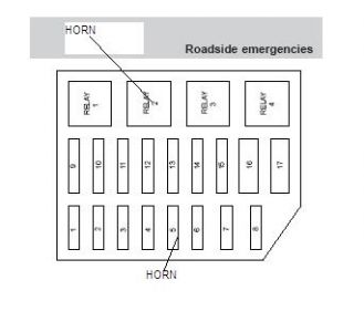

my vehicle has a short in the wiring causing the horn to constantly blow. i had to disconnect the battery in order to keep the battery from going off. where is the fuse location for the horn

What is your vehicle model? The info below is for a grand marquis
https://images.2carpros.com/forum/automotive_pictures/170934_grand_marquis_1.jpg
Horn fuse and horn relay, power distribution center under the hood.
