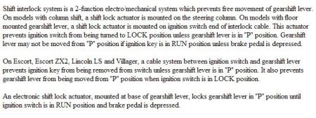

For a 2 weeks not my air conditioner was blowing just fine but it wasn't blowing cold air. When I started my car this morning the automatic tranmission stick was not move at all and air conditioner wasn't blowing anymore. Before this there was nothing wrong the transmission stick at all . Is there somebody who knows what is going on with this car?
Jul 11, 2009 at 2:32 AM
MHPAUTOS
  • 31,937 POSTS

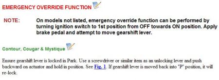

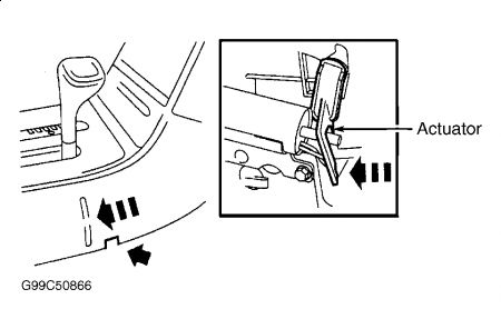

HI there, Thank you for the donation, See text for interlock over ride instructions, i hope this is of help. mark (mhpautos)
