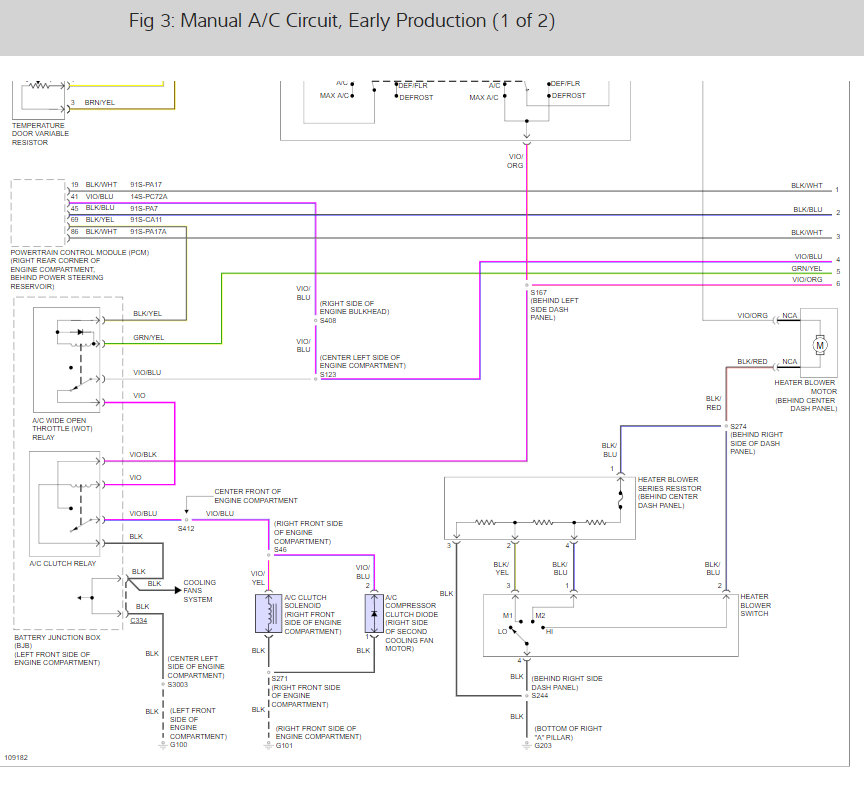

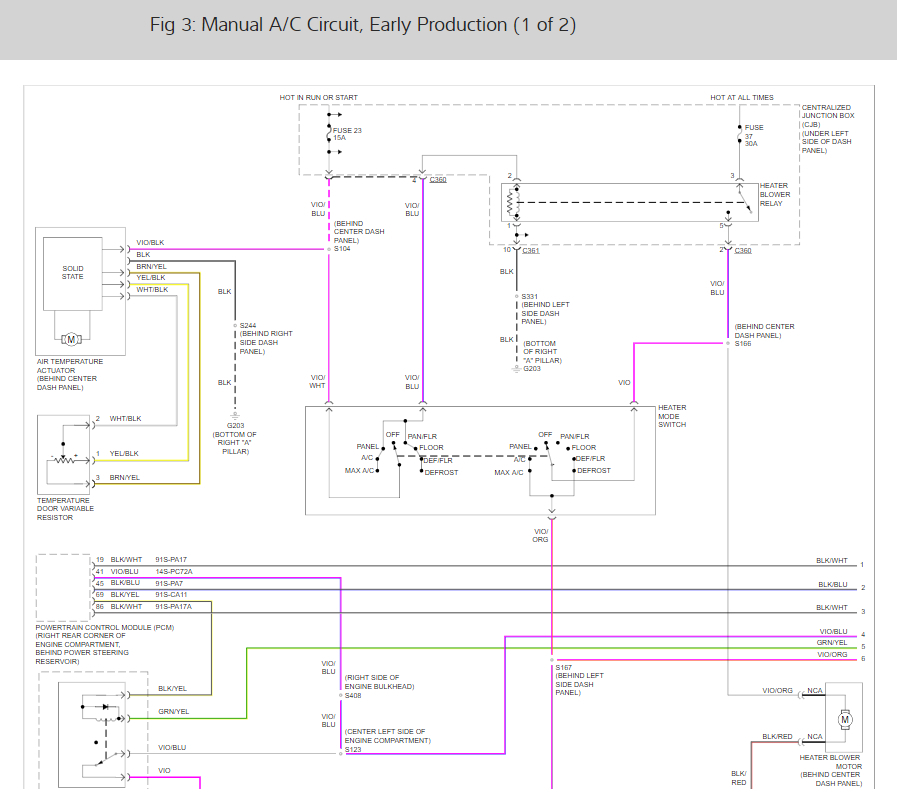

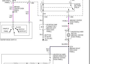

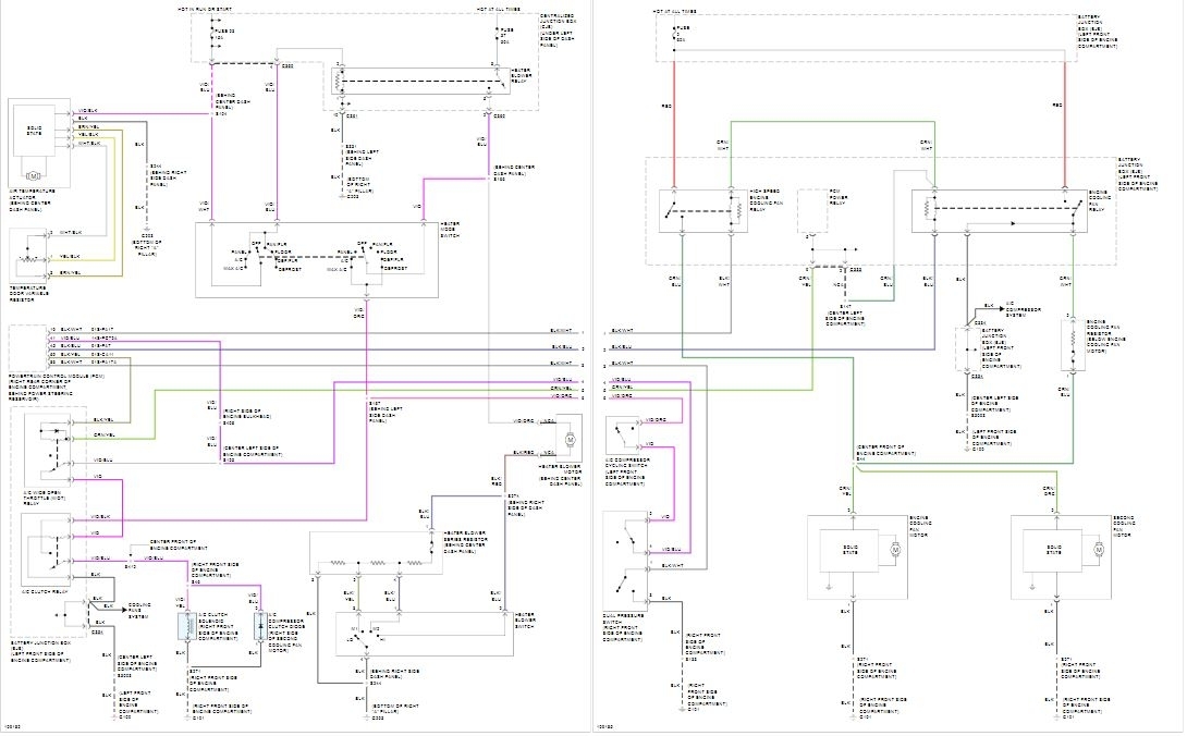

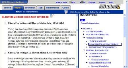

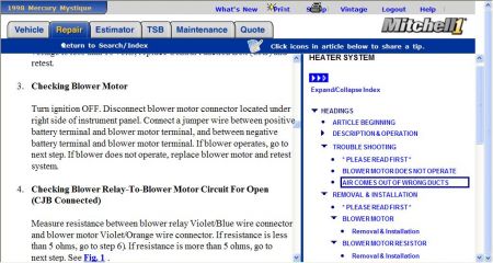

Try the blower motor relay see below, also the circuitry.
Here's a guide on testing wiring
Wiring diagrams are attached below

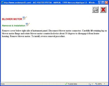

How do I take off the blower motor under the dash? I can not find the screws to take it off.
Monday, October 29th, 2018 AT 6:20 PM (Merged)
SATURNTECH9
  • 30,869 POSTS
https://www.2carpros.com/forum/automotive_pictures/416332_1999_mercury_mystic_blower_motor_removal_1.jpg
There's the info you need.
