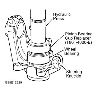

Tires and Wheels problem
1998 Mercury Mystique 6 cyl Front Wheel Drive Automatic
how to install front wheel bearing
Sep 22, 2008 at 3:49 PM
OBXAUTOMEDIC
  • 3,711 POSTS
Hello, Ok, unless you have a hub bearing remover/installer or a hydrolic press you won't be able to do it. Here is what the bearing looks like...
https://images.2carpros.com/forum/automotive_pictures/188069_wheelbrg_1.jpg
And here is installing...
https://images.2carpros.com/forum/automotive_pictures/188069_98mystiquebrginstall_1.jpg
