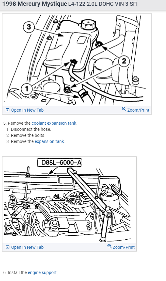

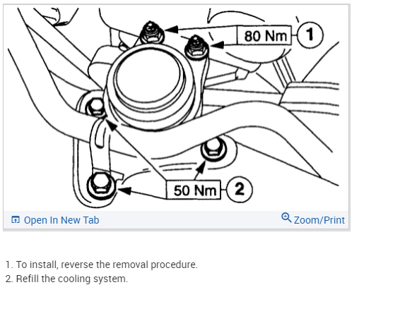

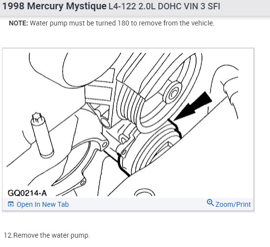

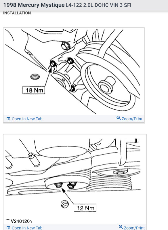

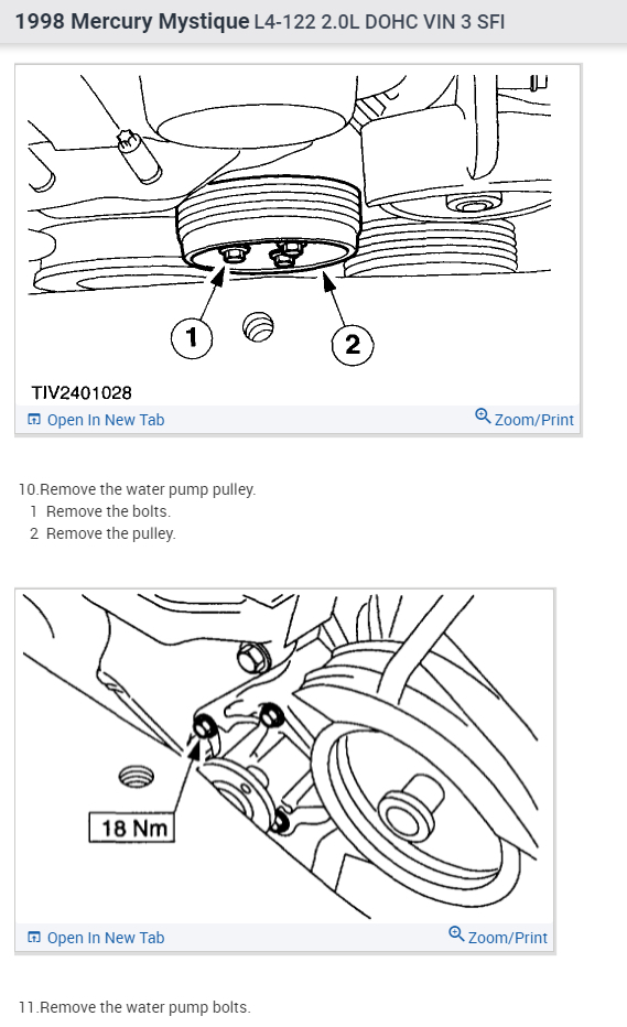

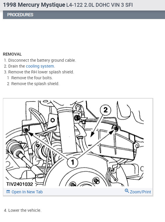

How long does it take to install Front motor mounts, water pump, and a front and passenger window lift kit?
Jan 27, 2009 at 11:09 AM
SQM
  • 6,383 POSTS
Remember to only work on the cooling system when the engine is cool.
https://www.2carpros.com/articles/water-pump-replacement
I have attached the water pump replacement guide below.
To help the next person who might be looking for instructions, please kindly open a new thread for the motor mount and the window regulator.
