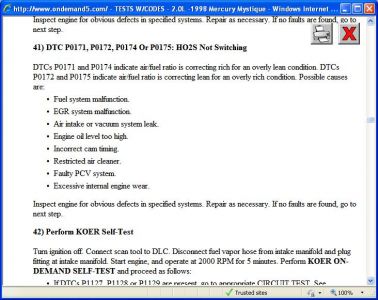

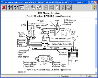

https://images.2carpros.com/forum/automotive_pictures/416332_1998_mystique_code_p0171_1.jpg
https://images.2carpros.com/forum/automotive_pictures/416332_1998_mystique_egr_diagram_1.jpg
No its not true that on a computer controled idle you cant spray around looking for a vaccuum leak.So spray all around with the carb spray to see if you have a vaccuum leak.I also posted the trouble tree for your p0171 and posted a diagram for your egr valve.ley me know what you find.

[quote:4ee4d34571="Ben Lee"]Thanks for the diagram.
I sprayed all around the engine, and especially tried to focus on hose connection areas, but I did not notice any changes in the idle.
If I can't find a leak, then that would leave:
-Restricted air cleaner (is this just referring to the air filter assembly?)
-Faulty PCV system (how do I check this system?)
-Incorrect cam timing (how do I check this? or is that way beyond the scope of the DIY'er?)
I'm also wondering why the check engine light seems to be coming on more quickly after less driving than it used to. Before I started all these repairs, it would take between 30-40 miles of driving for the light to come back on after the battery had been disconected...and when I used my code reader to clear the code most recently, it took only 2 or 3 miles for the light to come back on. So either way, whether by disconnecting the battery or by clearing the code w/ the reader, it is coming on much more quickly than before all these repairs were done.[/quote:4ee4d34571]
For restricted air filter there talking mainly about a really dirty air filter.But if you had a kink or restriction in your air tube going to your throttle body or something like also.A faulty pcv you remove it and inspect it for a weak spring or all gummed up faulty hose etc.As far as checking timming you would have to remove the valve cover and line up all your timming marks lets wait on that one.We also have the excessive internal engine wear which you would do a compression check to check that.Also have you egr valve to check.Let me ask you this does the code always reset at cruise like 40 mph range you showed me on the snap shot?Let me know.

I found the PCV valve coming off the oil separator on the front of the engine, but did not get any idle changes when spraying the connections as best as I could (was difficult since the bottle does not spray at all angles)...but where does the other end of the PCV valve tube lead to, opposite the oil separator?
I still can't find an EGR, and the one shown in my Haynes book looks just like the one in the diagram that you provided to me, but I still can't locate it. My mechanic did say that he checked the EGR (this was a few days ago) and that it was fine.

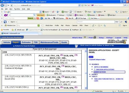

https://images.2carpros.com/forum/automotive_pictures/416332_1998_mercury_mystique_emmissions_1.jpg
I post the emmissions equipment your car should have you have to locate your vin letter or number for your car depending which letter you have you might not have a egr.When you find it refer to the chart i posted.As far as your pcv i couldnt find a picture or diagram for it.But the other end should go to a vaccuum source.Let me know what your find.

This car should not have an egr valve.

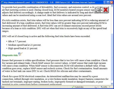

https://images.2carpros.com/forum/automotive_pictures/416332_mass_airflow_sensor_1.jpg
Dont pay attenion to the part that says code will set under these conditions.It explains how your mass air flow sensor works.If your scanner will read live engine data you can use your mass air flow readings to find a leak.What you do is hook up your scanner to read engine data scroll to your mass air flow readings and while your spraying around at idle watch your fuel trim readings if they changed alot like what i just posted then when you stop spraying it goes back to where it was then you have a vaccuum leak.Also look into what service writer told you i asked him to give me a hand with your car.let us know what you find.

Update: today was the last day for me to get a free re-test, so I reset the CEL to see if I could pass with lowered emmissions based on the work I have done thus far. The CEL stayed off, but my emmissions were about twice as bad compared to my first teset, which was BEFORE I did just about all these repairs and maintenance. Nitrous Oxide were both doubled at both 15 and 25 mph (last time I passed at 25mph, but failed at 15mph by about 160ppm)
Since it is MUCH worse than last time, I'm inclined to believe that the new MAF sensor is completely bad, and working even worse than the first one was. I will probably be changing it out again to see what happens.

Got the car passed for SMOG today, finally!! It was the MAF sensor that was keeping the check engine light on. I've driven over 100 miles since it was changed (for the 3rd time in 2 weeks) and no CEL and the smog numbers were back to normal. Aparently the first 2 sensors that were used for replacement were worse than the original one.
