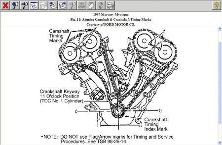

Engine Mechanical problem
1997 Mercury Mystique 6 cyl 120000 miles
where are the timing marks located? We are replacing the head gasget and timing belt.
Mar 29, 2008 at 4:21 PM
  • 75,992 POSTS
2.5L engine see below
https://images.2carpros.com/forum/automotive_pictures/12900_timing_3.jpg
