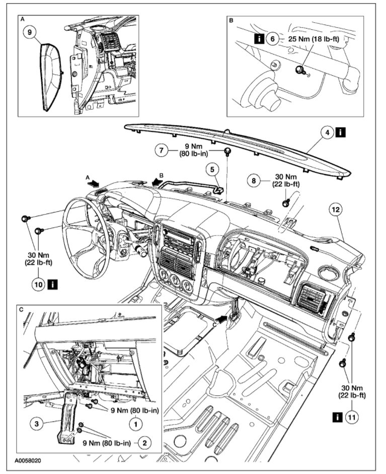

There is no quick fix for this problem and you cannot cut a hole in the heater box to make the job easier. Here is how the job is done.
Here is how it is done on your car

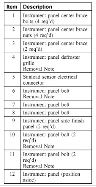

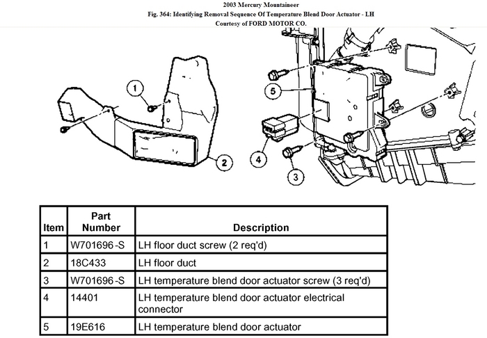

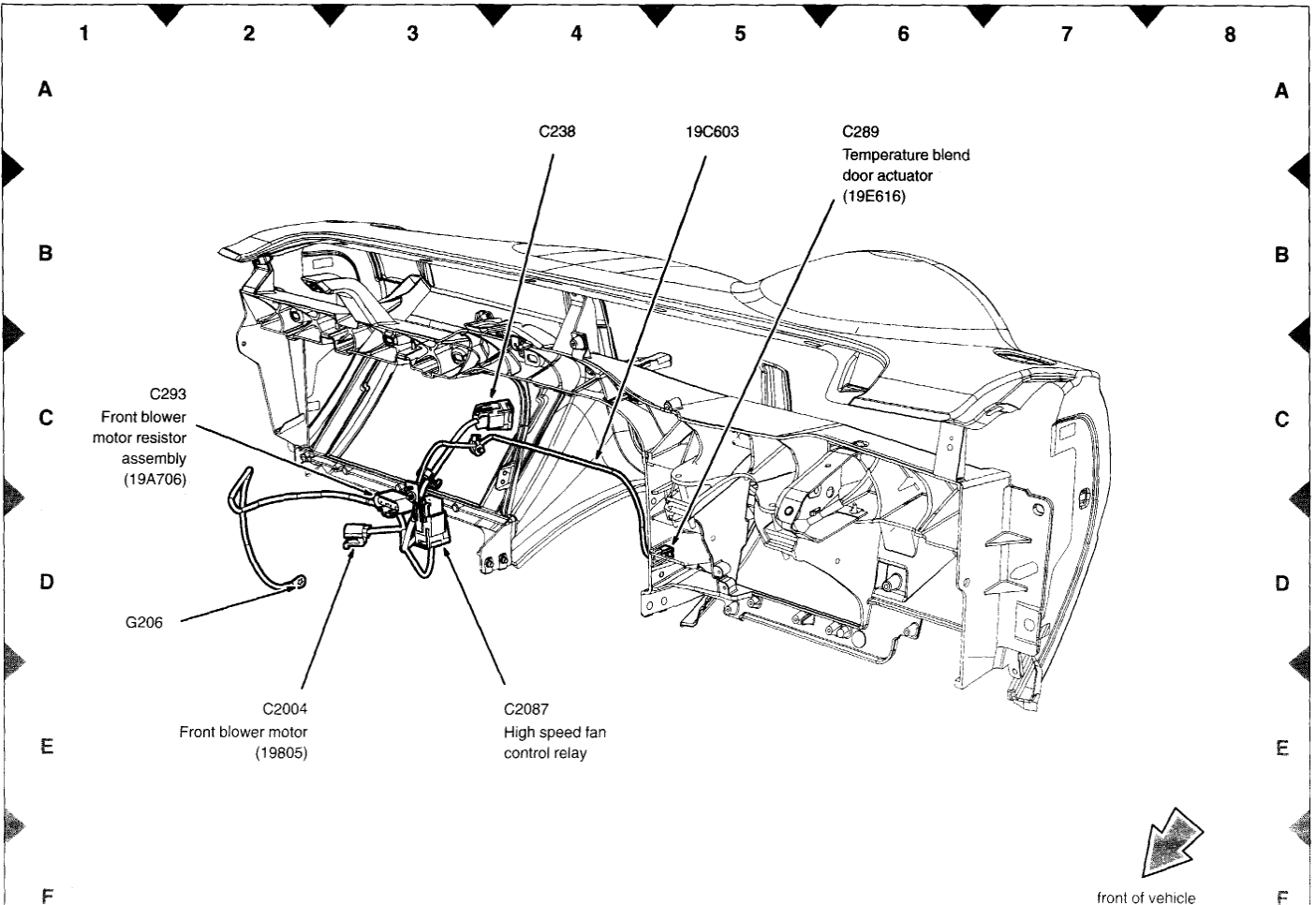

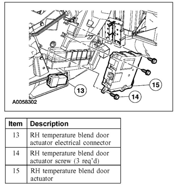

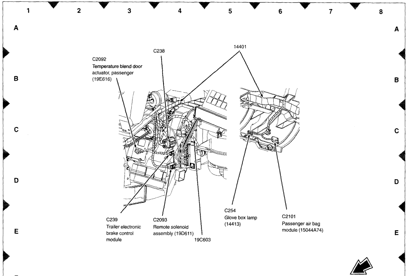

Are you talking about the temperature blend door actuator? Is it dual zone? The LH actuator is as shown in the picture below and can be done like this:
Actuator can be removed without removal of instrument panel. Remove console and the lower
steering column cover. Then remove in sequence shown in picture. Upper bolt can be
accessed through a hole just below, and to the right of column
