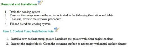

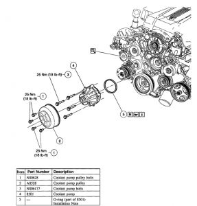

Would like to replace my water pump. Need help if you have information on getting this job done.
Thank You, Tammy Nicastro
Tuesday, May 11th, 2010 AT 5:42 PM
BLUELIGHTNIN6
MECHANIC
16,542 POSTS
+2
Tuesday, May 11th, 2010 AT 6:34 PM
