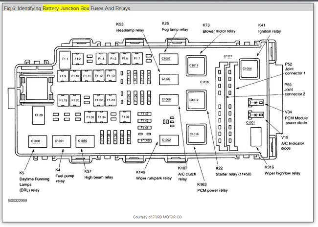

I am looking for the fuel pump relay?
Jul 21, 2010 at 2:38 AM
  • 75,992 POSTS
The fuel pump relay is located in the PDC under the hood here is a guide to help test it and the relay location in the diagrams below.
Check out the diagrams (Below). Please let us know what you find.

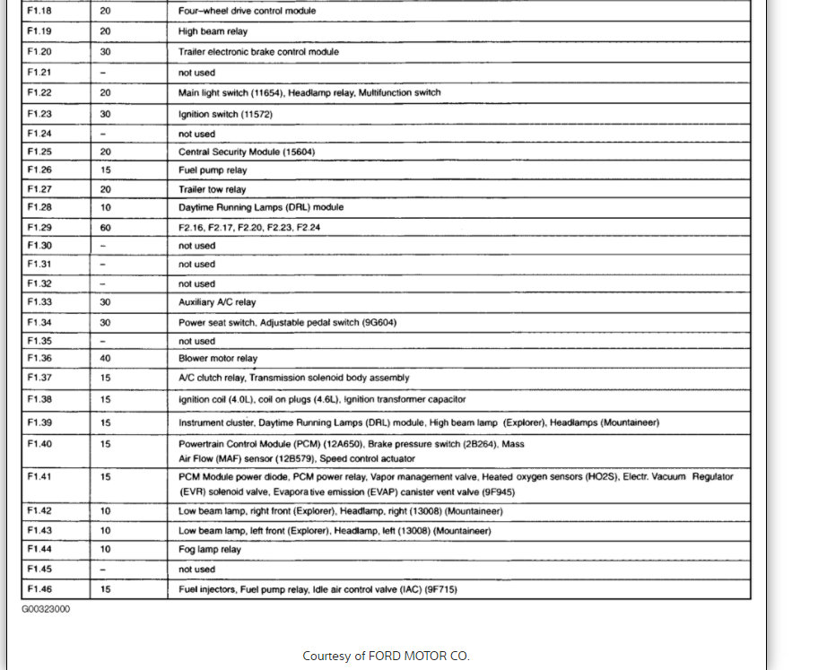

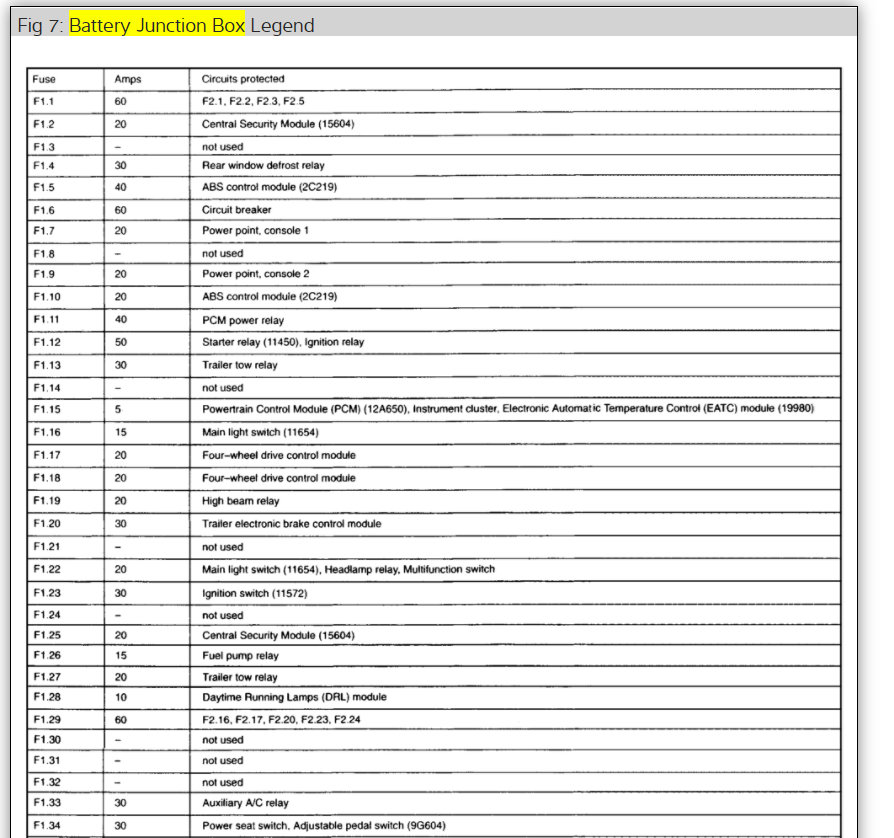

https://www.2carpros.com/images/external/118880584.jpg.gif F1.26 is the fuel pump fuse.
