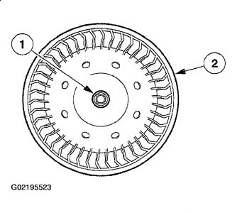

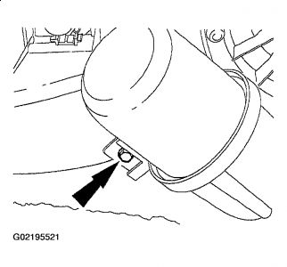

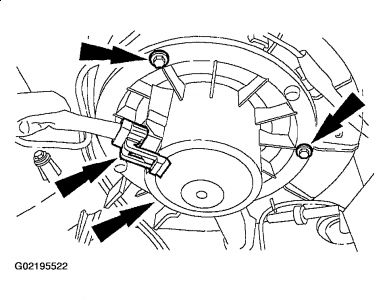

Removal and Installation Remove the screw and position aside the vacuum tank. Remove the blower motor. Disconnect the electrical connector. Remove the screws. Remove the blower motor. Remove the blower motor wheel from the blower motor. Remove the push clip. Remove the blower motor wheel. To install, reverse the removal procedure.
