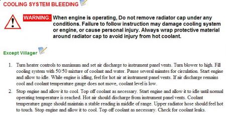

How do I bleed the radiator on a 2000 mountaineer with a 5.0 engine?

https://images.2carpros.com/forum/automotive_pictures/261618_Noname_1211.jpg
