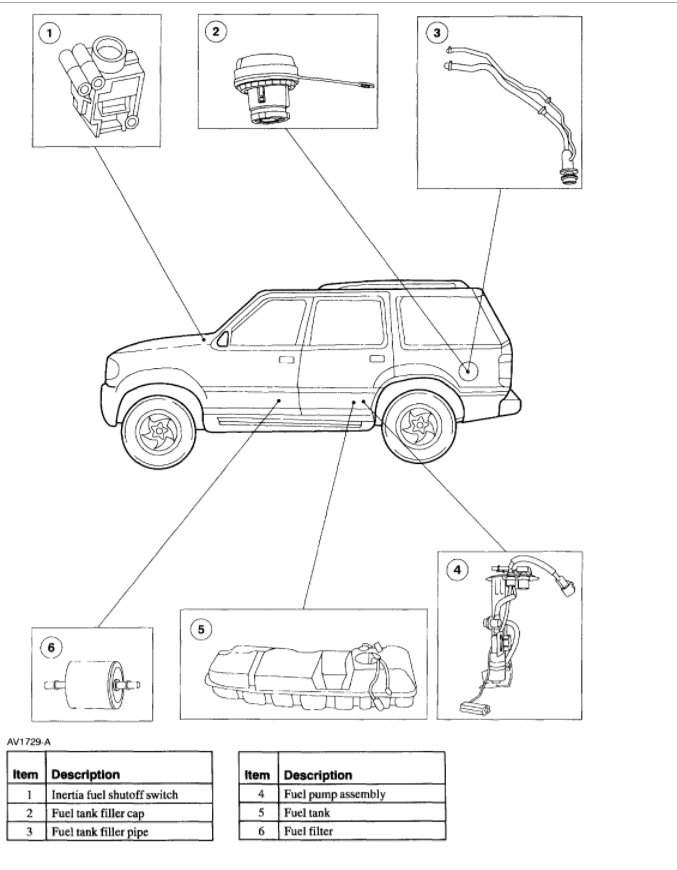

After turning vehicle off it would not start,.I tried to scan the comp.,but no codes came up,it has good spark. It keeps cranking but will not start.
Can you tell me where the cut off switch is please?

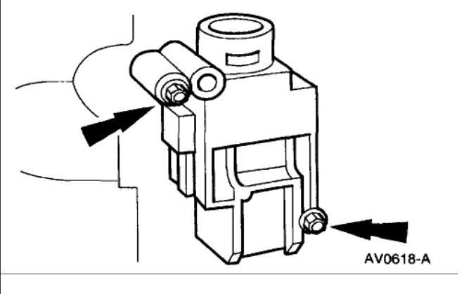

Your vehicle's inertia (fuel cut off) switch is located behind the right kick panel, also check fuses and fuel pump relay.
Here is a diagram of where it is (below)
