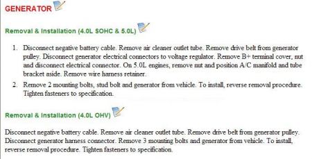

1. How do I know what amp it is 95 or 130?
2. How difficult is it to replace?

Should be stamped on the alternator or on a sticker under hood.
