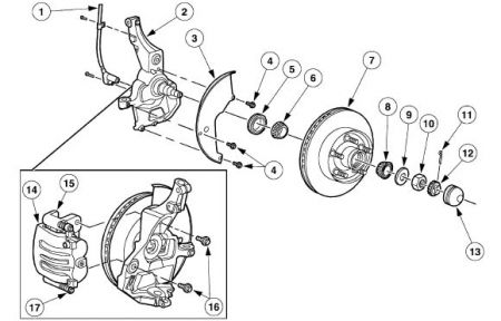

I have been having front end noise for about a week.Had the pads and rotors changed two weeks ago.On the way to work this am started grinding i stopped at stop sign grinding stop.it wouldn't go forward even though in drive.Went in reverse 10 feet then in drive ok to next stop.Got home took the wheel off the rotor and the caliper seem really loose.The bottom of the caliper isn't attached is there a bottom bolt that should be holding it tight?This could have been the cause of the noise.Also metal shavings are present and brake fluid splashes

Yes there are two bolts (1) that hold the caliper in place. They thread into a long "flat sided" head bolt. "Two" are used for each caliper. Here is a picture/sketch of the setup
https://images.2carpros.com/forum/automotive_pictures/433905_calipher_2.jpg
The "Two" Caliper anchor plate bolts #16 thread into "Two" Disc brake caliper bolts #17
https://images.2carpros.com/forum/automotive_pictures/433905_calipher_2_2.jpg
1 2C204 Front brake anti-lock sensor 2 3105 Front wheel spindle 3 2K004 Brake disc shield 4 N611171-S2 Bolt 5 1190 Grease seal 6 1216 Front wheel bearing 7 1102 Brake disc and hub 8 1216 Front wheel bearing 9 1195 Front wheel outer bearing retainer washer 10 374504-S36 Hub spindle nut 11 N642569-S Cotter pin 12 390622-S Nut retainer 13 1131 Hub grease cap 14 2B120 Disc brake caliper 15 2B292 Front disc brake caliper anchor plate 16 N805163-S190 Caliper anchor plate bolts 17 2N386 Disc brake caliper bolt. THE TWO "DISC CALIPER BOLTS" #17 HAVE A FLATS ON EACH SIDE OF THE HEAD THAT LOCK THE BOLT IN PLACE TO KEEP IT FROM TURNING. THE 2 CALIPER ANCHOR PLATE BOLTS #16 THREAD INTO THE DISC BRAKE CALIPER BOLT #17. THE "TWO" CALIPER ANCHOR PLATE BOLTS #16 ARE TORQUED DOWN TIGHT !! YOU MENTIONED THE BOTTOM CALIPER ANCHOR PLATE BOLT IS MISSING. THE MISSING BOLT IS "ABSOLUTELY" WHAT HAS CAUSED THE PROBLEM !!! If you had the brakes done at a shop someone screwed up "BIG TIME". What happened has caused damage !! Metal shavings,brake fluid etc. I would take it back and tell them you want everything replaced "New". They will probably give you a song and a dance and say it was not their fault and the bolt was in place when the job was done. Take them to small claims court. Oh my aching A$$ ...to put it mild !! "I wish I could state my actual words I am now thinking about this". What "you" are thinking reading this.... we probably are using the same "choice words" dictionary. This could have been much,much worse...you or someone else could have also been injured!!!!!!! Good Luck; Rick
