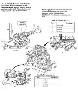

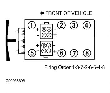

Replaced both coils on my '97 Mercury and need to know where the plug wires go on top.

https://images.2carpros.com/forum/automotive_pictures/99387_Graphic1_682.jpg
https://images.2carpros.com/forum/automotive_pictures/99387_Graphic2_315.jpg
