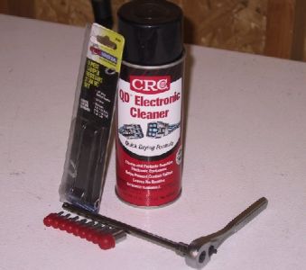

Hello -
One last note. . .. . .. . ..try cleaning the Mass Air Flow sensor with some electrical cleaner. Go easy.
https://www.2carpros.com/forum/automotive_pictures/248015_6_23.jpg
Thursday, August 27th, 2009 AT 11:07 PM
