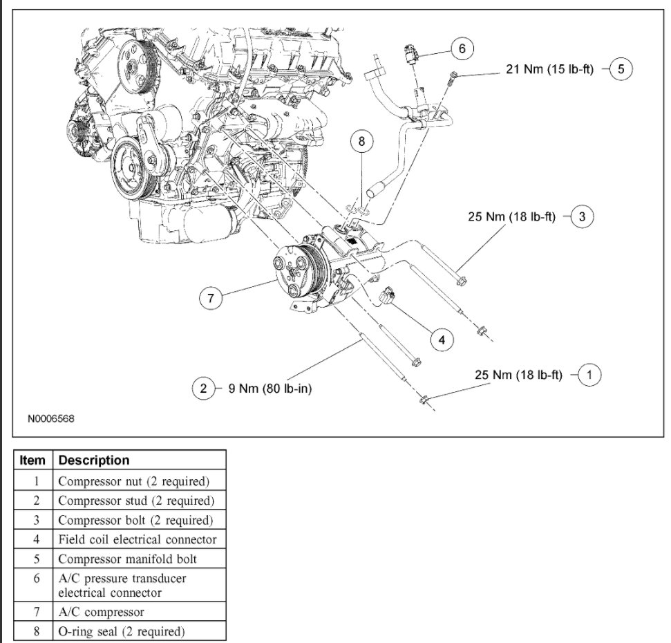

It sounds like the ac compression has gone out or has weak seals. Here is a guide that will show you what you are in for when doing the job.
https://www.2carpros.com/articles/replace-air-conditioner-compressor
and
Diagram (below)
