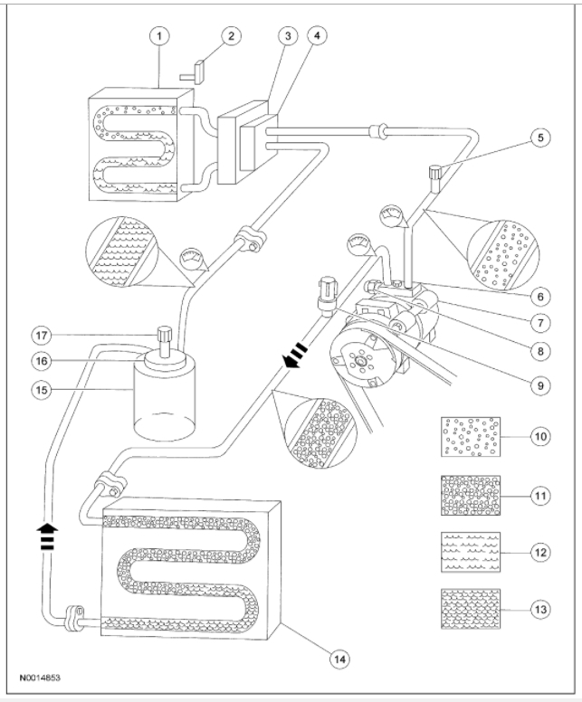

how do I recognize the ac low pressure port from the high pressure port? Where are they?

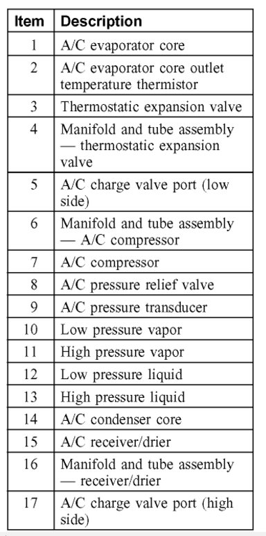

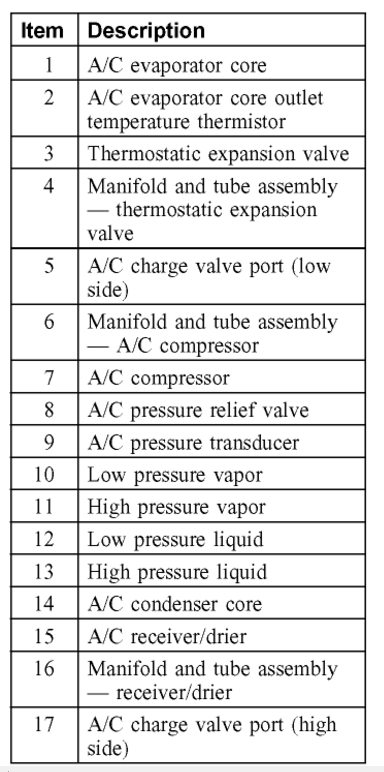

The high side port is smaller around than the high side. Here is a guide and some diagrams to help you get the job done.
https://www.2carpros.com/articles/air-conditioner-how-to-add-freon
and
and
https://www.2carpros.com/articles/how-a-car-air-conditioner-works
The low side port is on the tube or hose that comes from the firewall and goes to the compressor.
