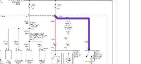

Is there a fuse for the cigarette lighter on a 2007 Mercury Milan. Can you tell me what size it is and where it is located? Thank You.

Hi dlmiller2957 and TY for the donation Check fuse no. 15 20amp if okay the red wire from the fuse holder to the cigar lighter is open or the ground circuit G300 at center of left floor pan, also inspect the cigar lighter element could be open. Good LUck See below diagram:
https://images.2carpros.com/forum/automotive_pictures/12900_cigar_lighter_1.jpg
