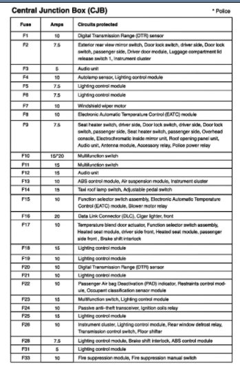

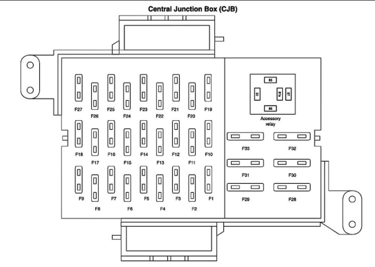

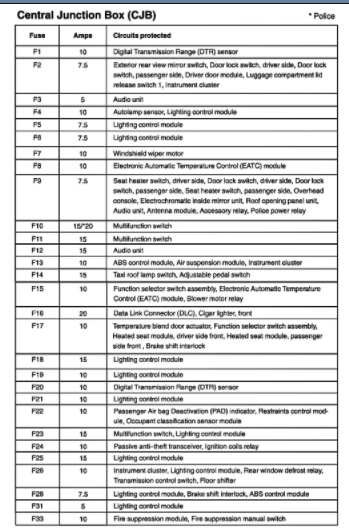

Lights are not working for the interior can you tell me where the fuses are?
Thursday, May 1st, 2008 AT 3:22 PM
DANNY L
MECHANIC
5,648 POSTS
Hello, I'm Danny.
Here is the information you requested. Here a few tutorials for you to view on how to check and replace fuse:
I've attached pictures below showing the fuse locations on your car. Hope this helps and thanks for using 2CarPros.
