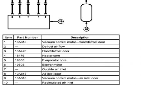

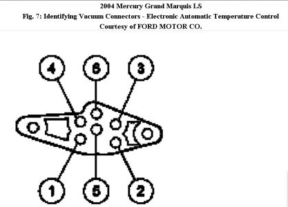

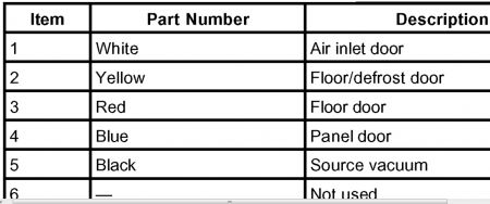

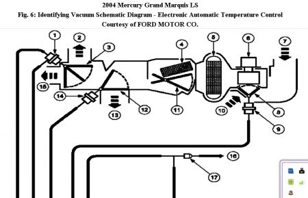

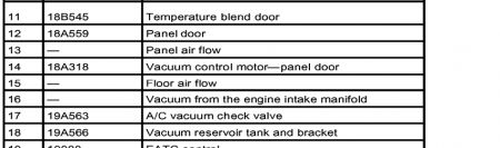

Air Conditioning problem
2004 Mercury Marquis V8 Two Wheel Drive Automatic
What are the lines to (color codes) for the vacuum lines on the ac control module with ATC?
