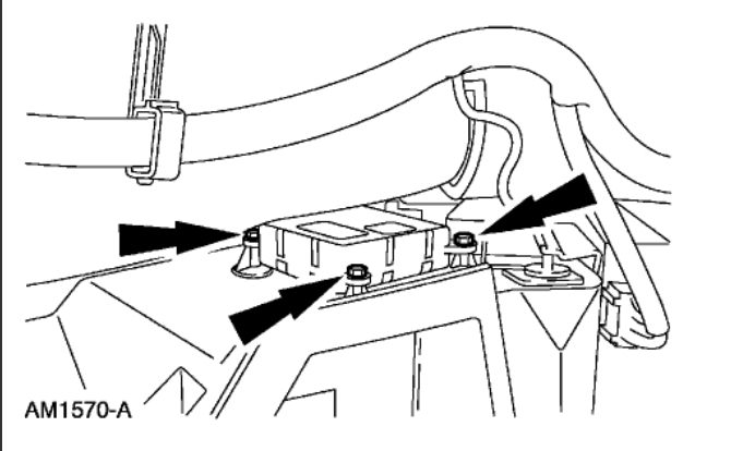

my ac started blowing hot all of a sudden. We tried to put freon but it did nothing. It doesn't blow warm ...it blows hot like the heater is on. The blower works on all settings. Please help
May 15, 2010 at 9:03 AM
  • 55,186 POSTS

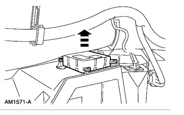

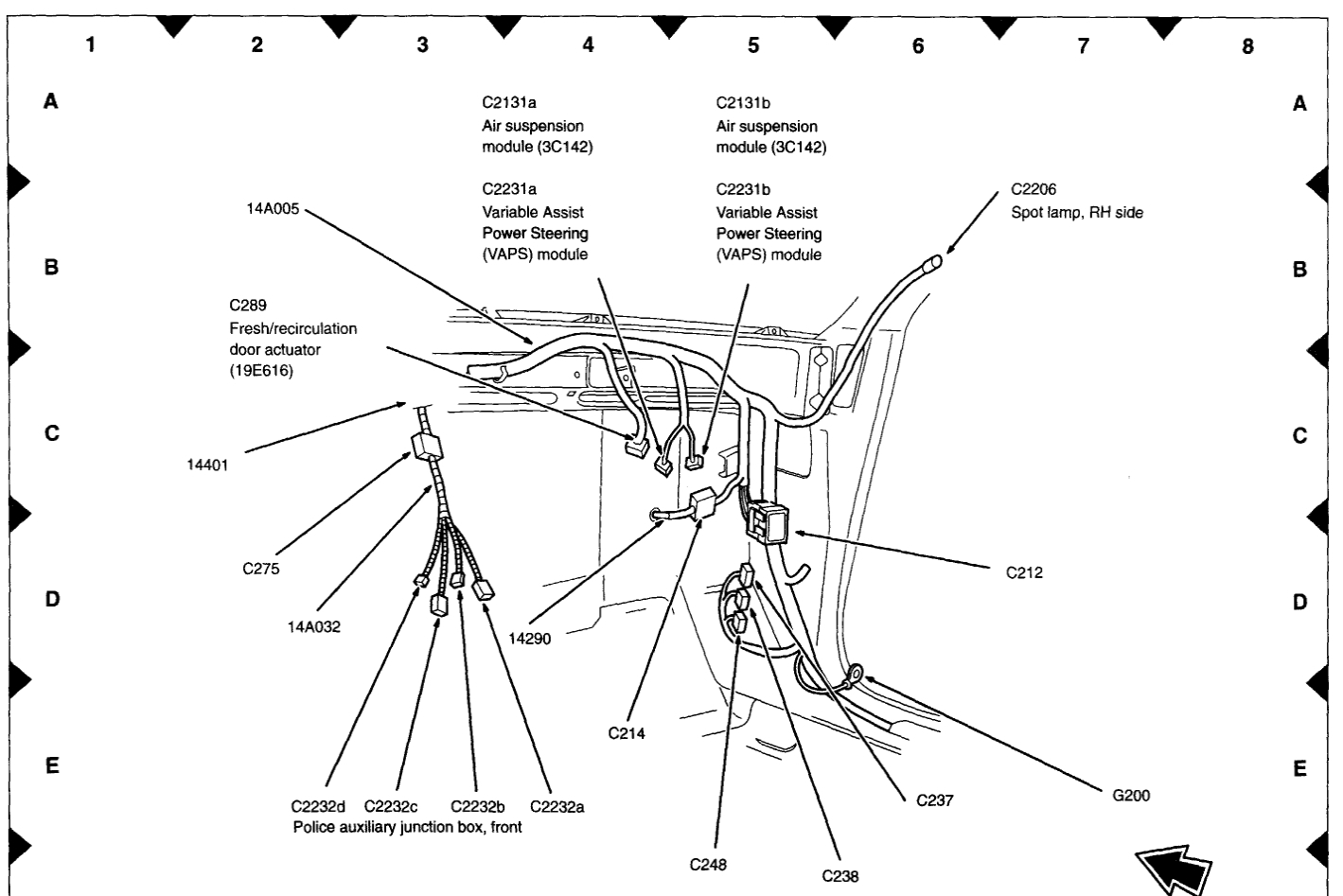

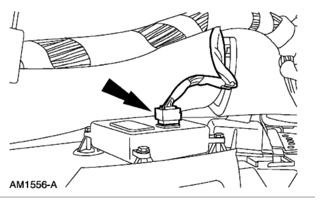

It sounds like you have a temperature blend door actuator that needs to be replaced. When these go out it causes the heater to come on. Here isa guide to help you see what you are in for when doing the job.
Here is what it will be like for your car (below)
