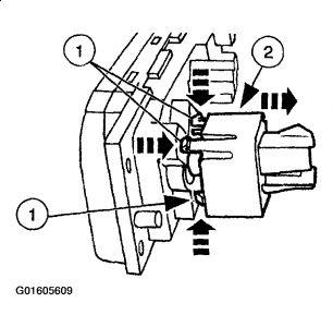

where is the blower/heater switch located on a 2003 mercury grand marquis?

Blower motor switch is located behind climate control assembly.. remove assembly, pull and remove switch knob. remove switch by releasing the tabs then removing the switch.
https://www.2carpros.com/forum/automotive_pictures/261618_Graphic_310.jpg
blower motor relay is located in battery junction box (in right front of engine compartment, behind battery).
