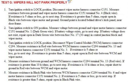

When I turn on the wipers they function. When I go to shut off they stay on the windshield instead of going to the normal off position at the bottom of the windshield. What causes this, and how can I repair?

perform following tests in order to prevent misdiagnosis and replacement of potentially good components..
https://images.2carpros.com/forum/automotive_pictures/261618_Noname_922.jpg
https://images.2carpros.com/forum/automotive_pictures/261618_Noname2_245.jpg
